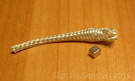

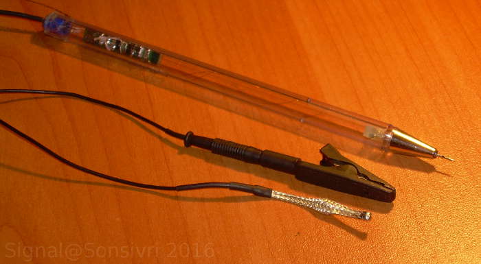

I think it is a known issue - crocodile connector is not very reliable especially when it connects to exterior parts of equipment chassis that is not intended for that. Wire moves around and crocodile slips out. You come with multimeter or oscilloscope in hand to make some tests, start from searching place to clutch a "ground", apply crocodile, find suspicious place on PCB or wire harness, tip the probe and finally discover disconnected ground.
Considering draft measurement situation I need a fast and reliable temporary ground connection as a potential reference. Just to slap a case/chassis by ground probe would be nice. No need to hold strongly - it have to release smoothly when I pull the wire. If a case is "grounded" and is made of steel - the solution is possible.

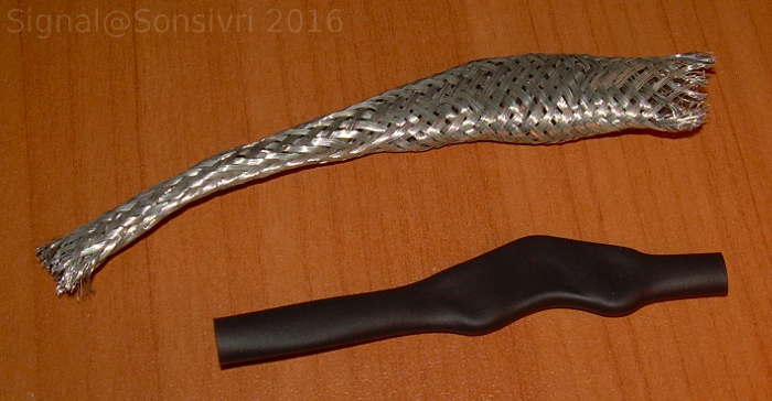

Tinned copper braided sleeve and neodymium magnet

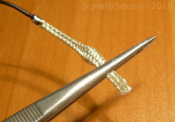

Magnet inside sleeve. Before closing soldering

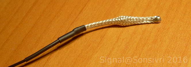

Completed terminal

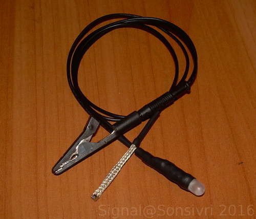

Test LED with "sticky" minus
Different options for simple logic probe

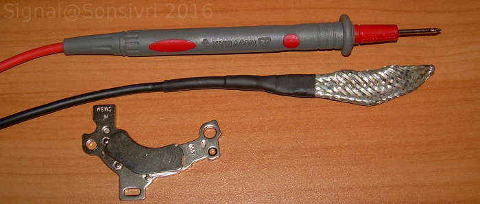

Heavier probe wire requires bigger magnet
Magnetic fixing probe for multimeter

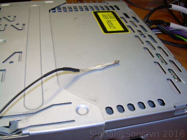

Application examples:
In contact with radio chassis

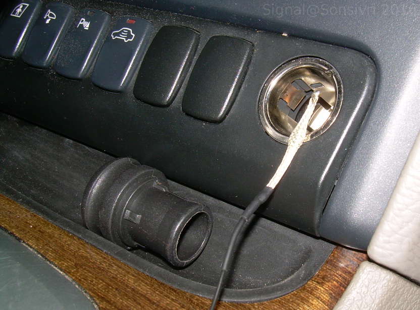

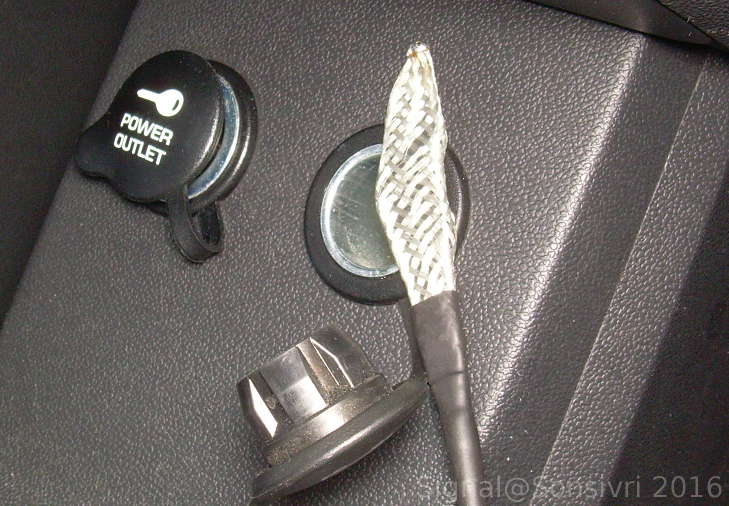

Ground reference from power "lighter" outlet
Actually the smaller terminal requires much less open ground surface for reliable fixing so cap could stay in receptacle
"Lighter" outlet plug is an obvious option here but not nearly so universal.
